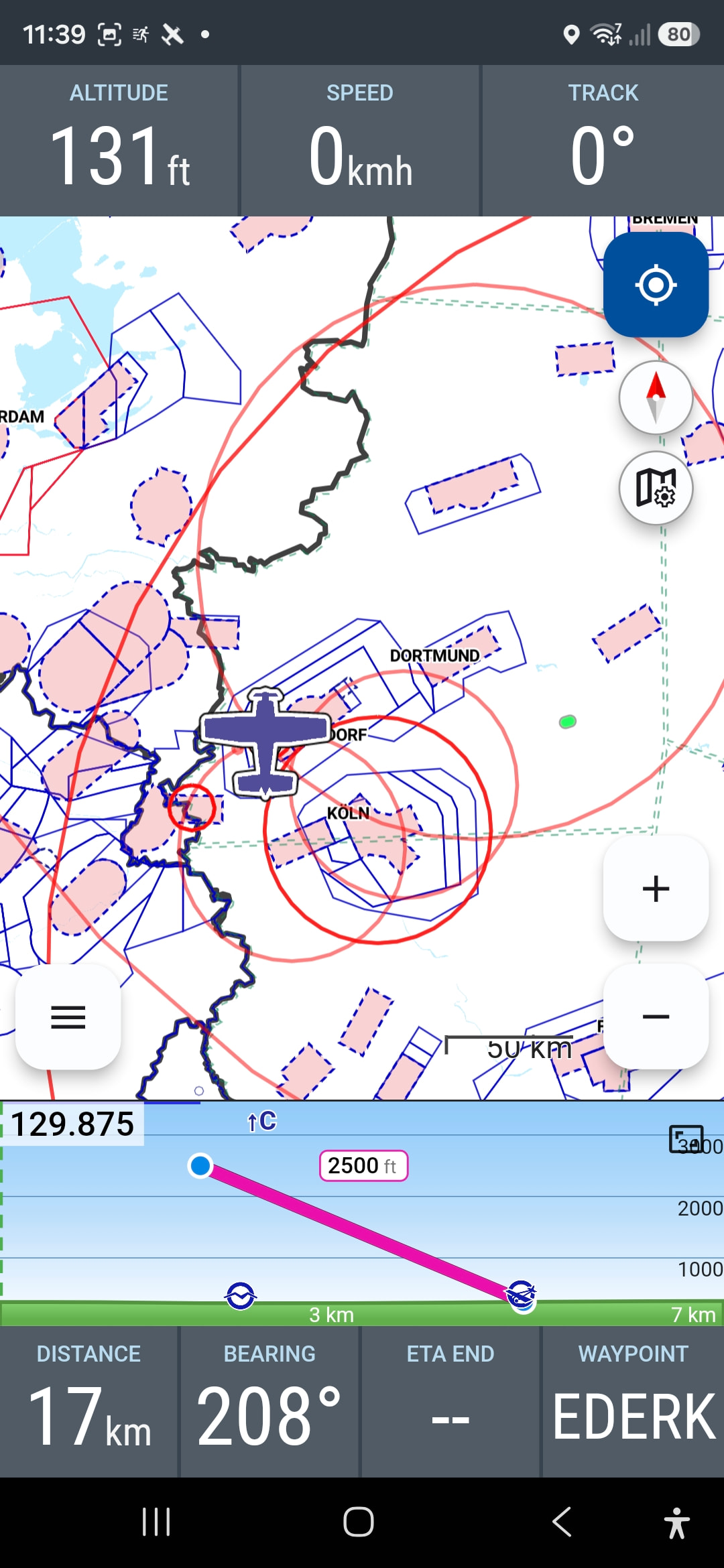

Hi everyone, I’ve only been using the program for a short time. What I’ve noticed is that red, sometimes large circles are being displayed. What are they?

These are the NOTAMs for your planned route.
Those are the same ones you see in flight planning in the NOTAM tab.
You can enable and disable the display via the map settings. That’s the button under the compass.
