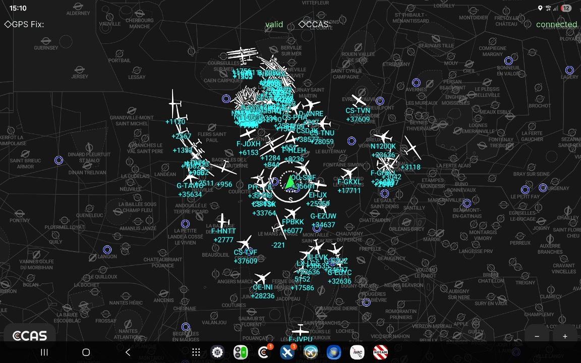

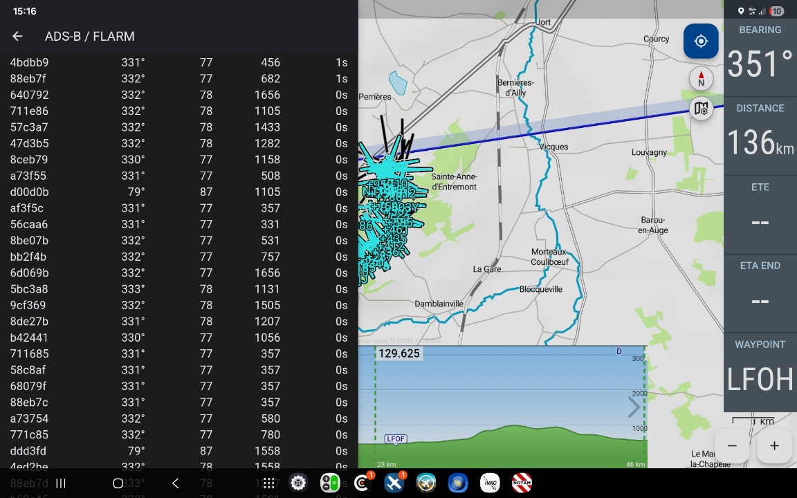

Duplicate glider on CCAS VFRnav?

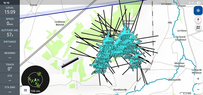

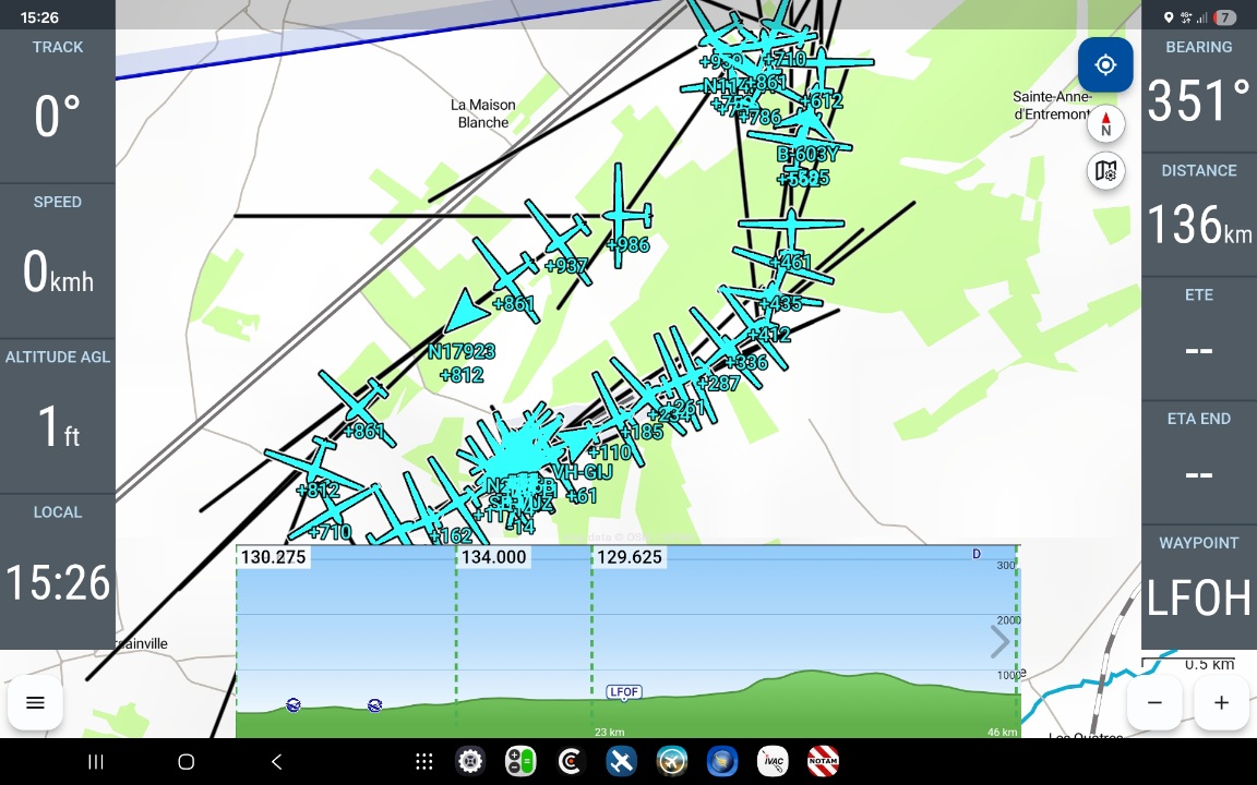

How can we explain the duplication of this glider?
  • Did the owner tinker with an Arduino/FLARM/Stratux setup?
  • A CCAS fault?
  • A VFRnav fault?
This also raises the question of being able to quickly silence the audible alarm, since these 36 aircraft do not exist… except for one.
I also had a case of an in-flight collision alert on the CCAS radar while I didn’t see the aircraft… I turned back to look for it and saw it a minute away (very far). This effect seems due to information latency.
Is it fair to conclude that there is no precise, time-coordinated temporal information tied to position in CAS systems?
Also, aircraft that appear to be arriving from afar may already be very close, and those that should be approaching us may have already passed?
Thanks for your input.
Daniel.

  • What does CCAS show on its own? Surely not a thousandfold? Or?
  • Have you paired a Stratux or Flarm to CCAS?
  • What do the received traffic data in VFRnav show? Correct there?
