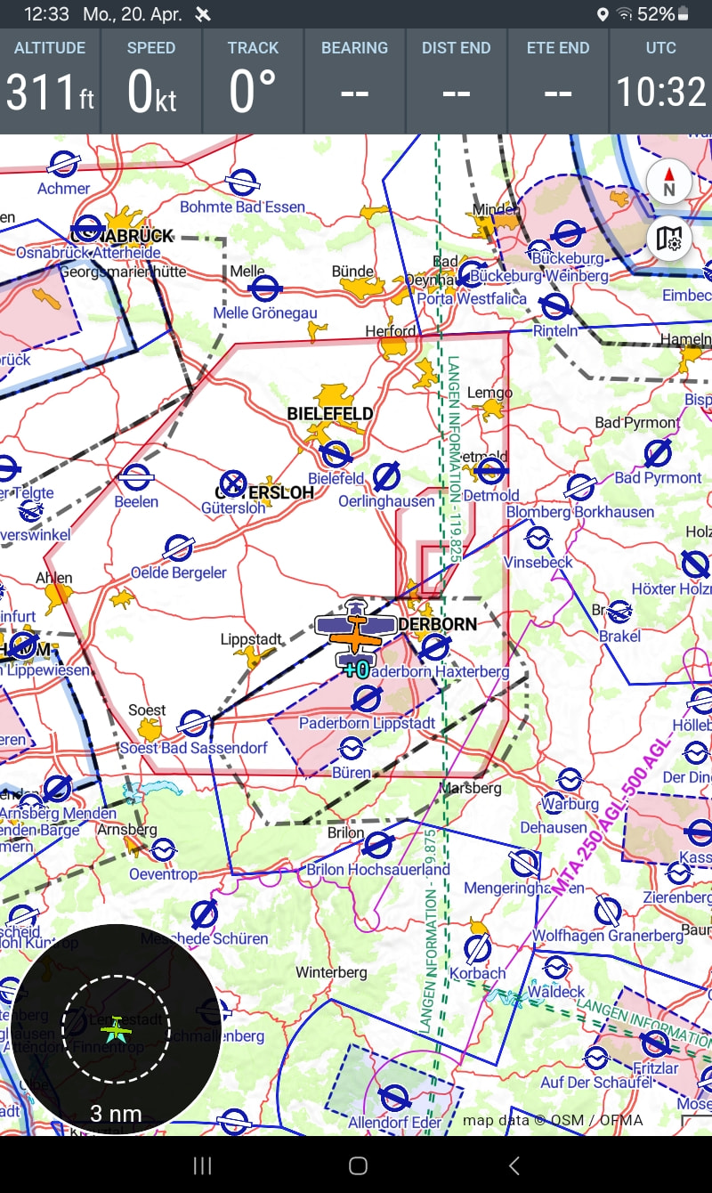

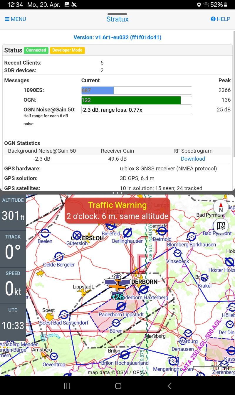

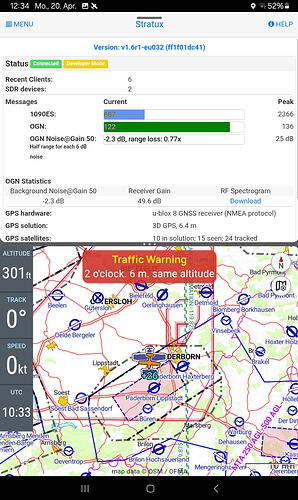

I tried a bit more. When I set split screen on my tablet, with the Stratux interface (Stratuxoberfläche) on top and VFRnav at the bottom, I also get the message. Then it doesn’t matter whether TCP or UDP is enabled. If I only have VFRnav running, no message appears :thinking:

@Sven if I understand correctly, you would have both alarms.
Your first split screen in smartphone mode(?) displays a message (and not the radar) your second screen in tablet mode displays the radar (you can clearly see the two devices on top of each other!)
So graphically it looks OK?
For the sound I don’t know, because it’s not in the images :wink:
Indeed we’re lacking information about how it works :face_with_monocle:
Ahhh, that was the crucial hint, thanks. It works in smartphone mode — the message appears; in tablet mode only the radar circle appears…..:+1:
