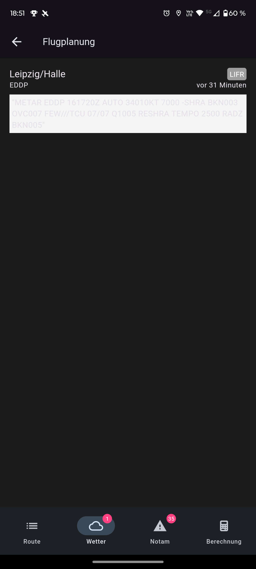

When running the app in dark mode, the METAR is hard to read. (dark screenshot).

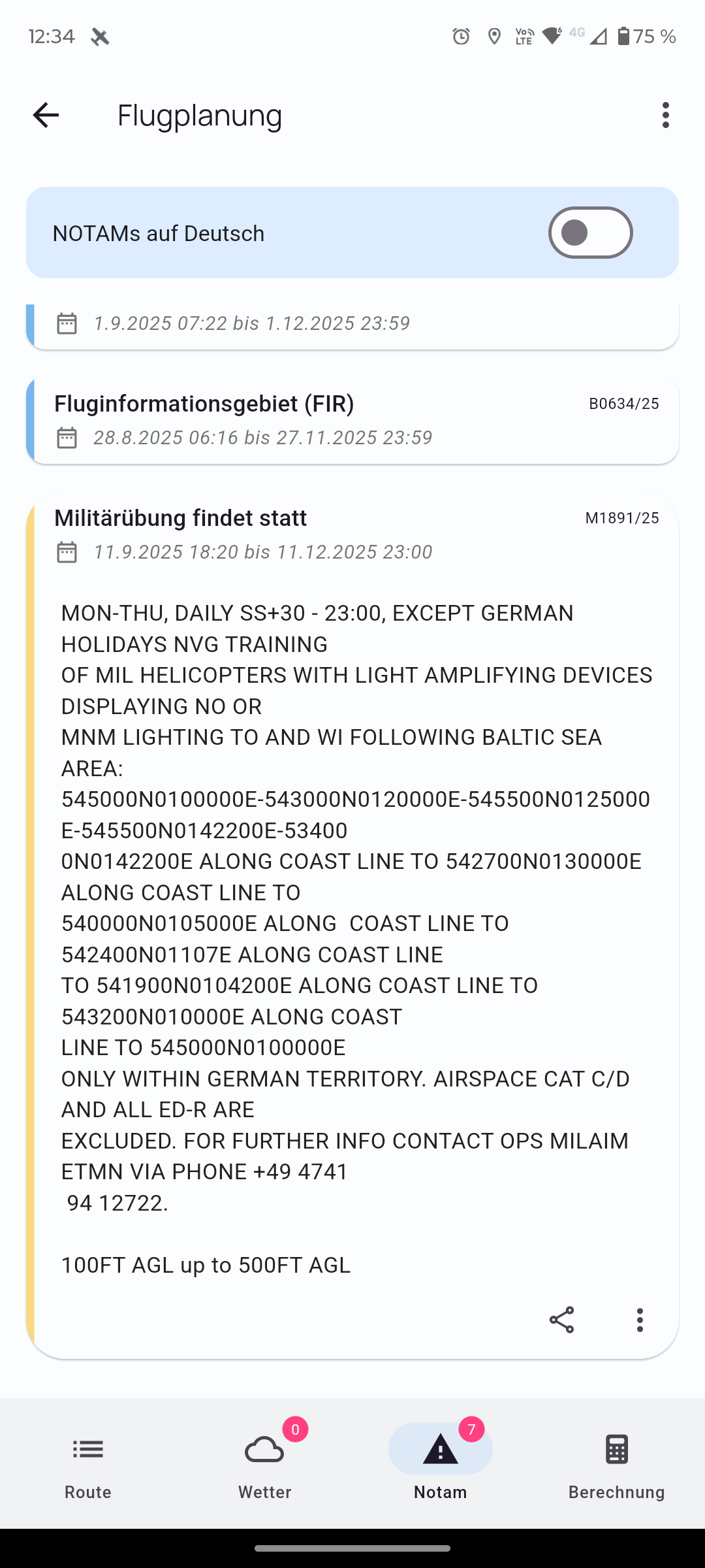

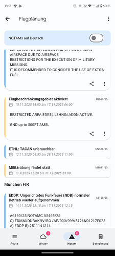

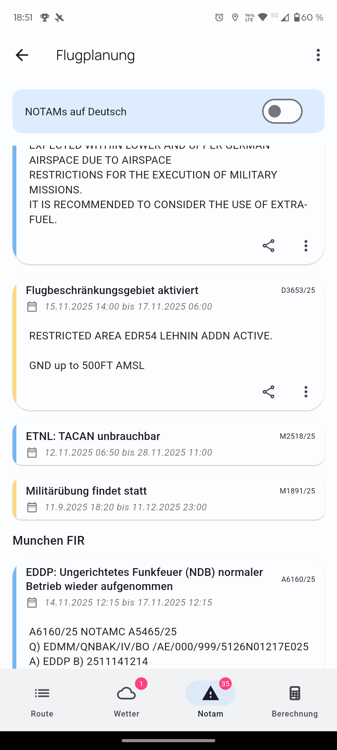

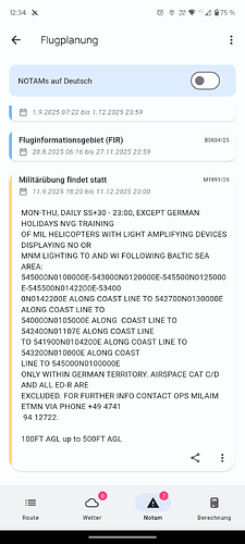

On the map, the NOTAMs are displayed.
That’s great. Maybe you could add a ‘show on map’ option in the list? Especially for longer routes, I find that helpful, since you can then view them directly on the map.
Many thanks for the heads-up.
This happens when decoding of METAR/TAF messages has been disabled in the settings. It will be fixed in the upcoming version.

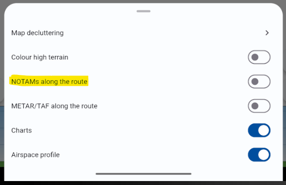

Do you mean this option?
Ah great, then it’s already known and I’ll switch to ‘dark’ with the next update.
The option displays the NOTAMs on the map.
What I meant was that from the NOTAM overview you can display the NOTAM on the map and, with a button (which you could add to the three-dot menu), jump straight to the map and have the NOTAM’s circle displayed.
Ahhh, all right. I get it now :+1: :grinning_face:
Thanks for the suggestion! I’ll add that to my to-do list and see how it can be implemented elegantly.
