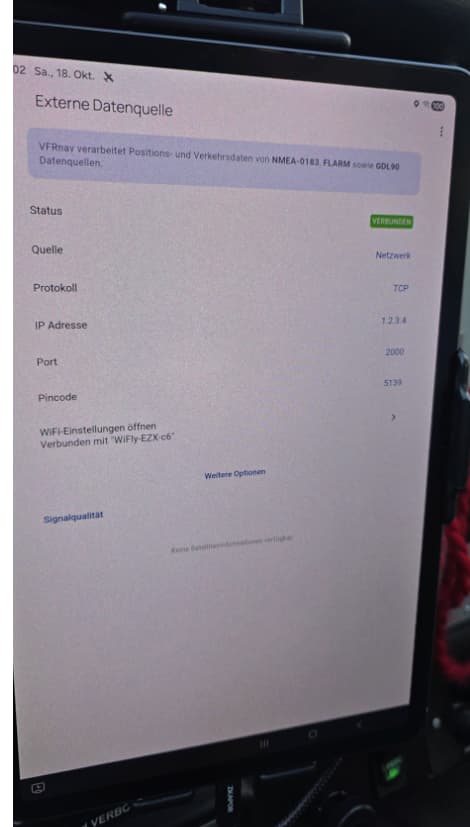

The “Vernindung steht” …does that mean you see traffic data arriving under Settings? …just not on the MovingMap? …a Sceenshot is always helpful!

Screenshot 2025-10-18 at 18:52:44
By “connection” I mean that the connection from Airconnect to VFRNav is established, see image attached. However, the FLARM data is no longer displayed on the map, i.e. the other aircraft approaching me. Before the update these were displayed with altitude information etc. It can only be due to VFRNav since with other programmes the data are still displayed.
…and these values are correct as in the screenshot?
I don’t know the port number for the device. But the IP address already raises big questions! That’s definitely not an IP. Since you chose Network-TCP as the connection, that can’t be right. Can’t you use UDP instead of TCP?
Again: Yes, the values are correct. The whole thing worked like this until the update.
I have the IP address from the manufacturer. It worked like this !!!

IP: I do believe you that it worked that way. According to AirAvionics the IP 169.254.1.1 would be equivalent to 1.2.3.4. The internal data communication is apparently serial on the devices.

Thanks to Hermann’s kind support, it worked with 1.2.3.4 :slight_smile: Everything is working fine. At the moment the weather isn’t suitable for flying either; Hermann has already got in touch to say he’ll be back next week.

The 1.2.3.4 is indeed correct – this is an older AirConnect that uses this IP. Some NMEA data sets differ here from newer devices, which has caused this error after the last update.
