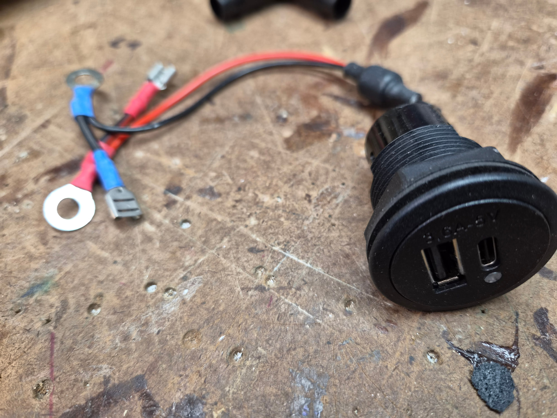

From the camper/RV supplies I have a panel-mounted socket that also works. Unfortunately I don’t have any link for it anymore.
