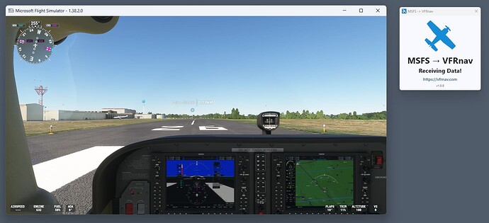

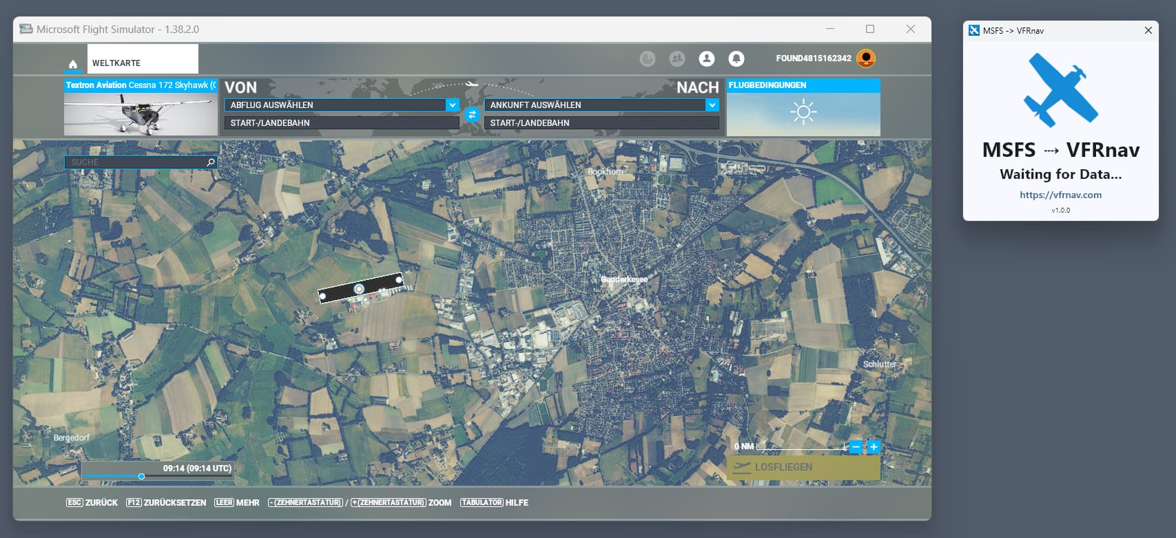

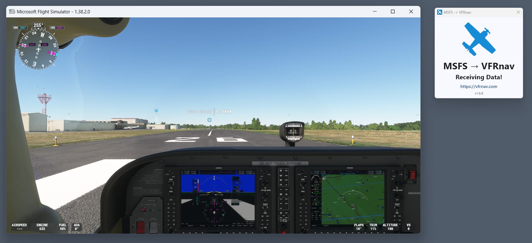

My setup:
  1. Start the Flight Simulator and MSFS2VFRnav. Open the world map. Choose a departure point. “Take off”
  1. As soon as it’s loaded, the display in MSFS2VFRnav switches from “Waiting for Data…” to “Receiving Data!”.

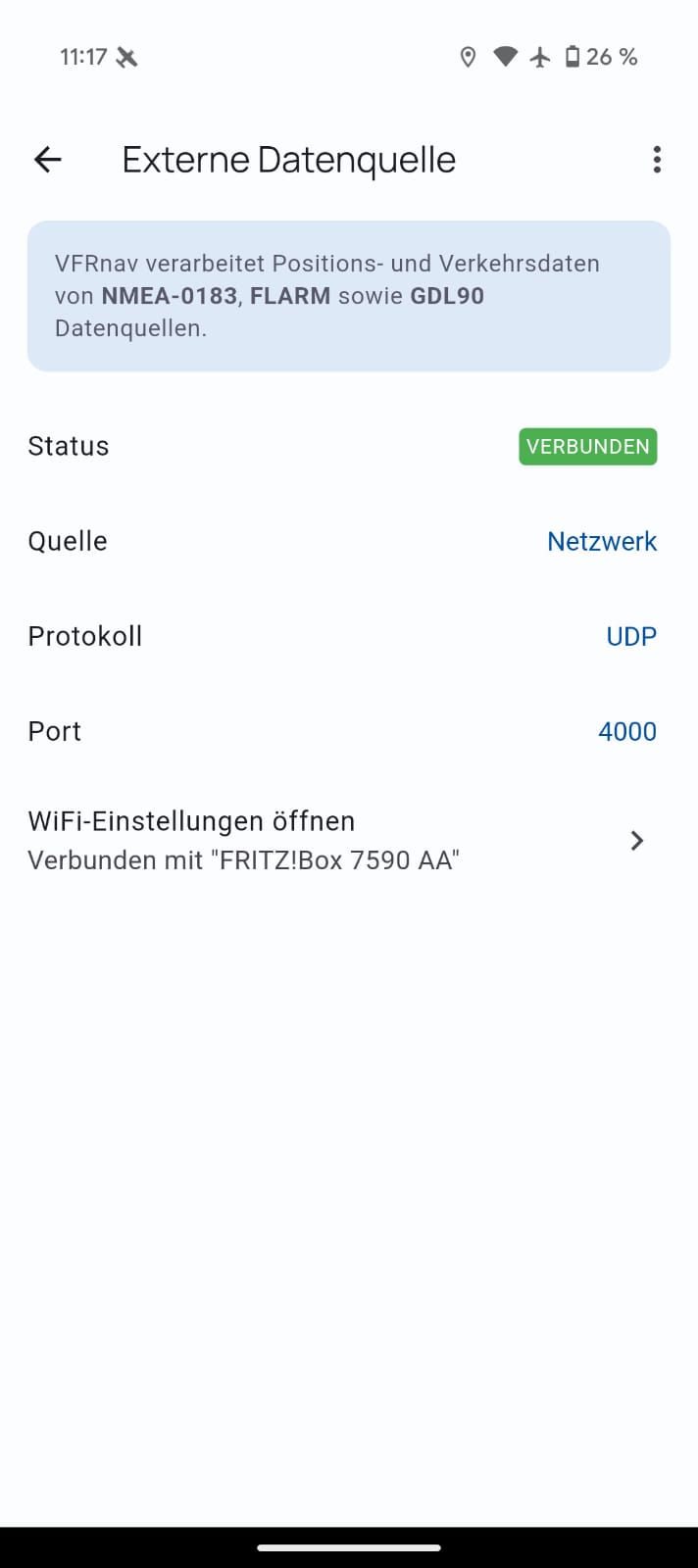

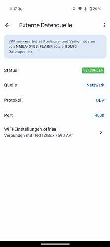

  1. In VFRnav, set the default options under “External Data Source” as follows:
Both PC and phone are on the same Wi-Fi network. The router is configured to allow Wi-Fi devices to communicate with each other. No changes have been made to the Windows Firewall.

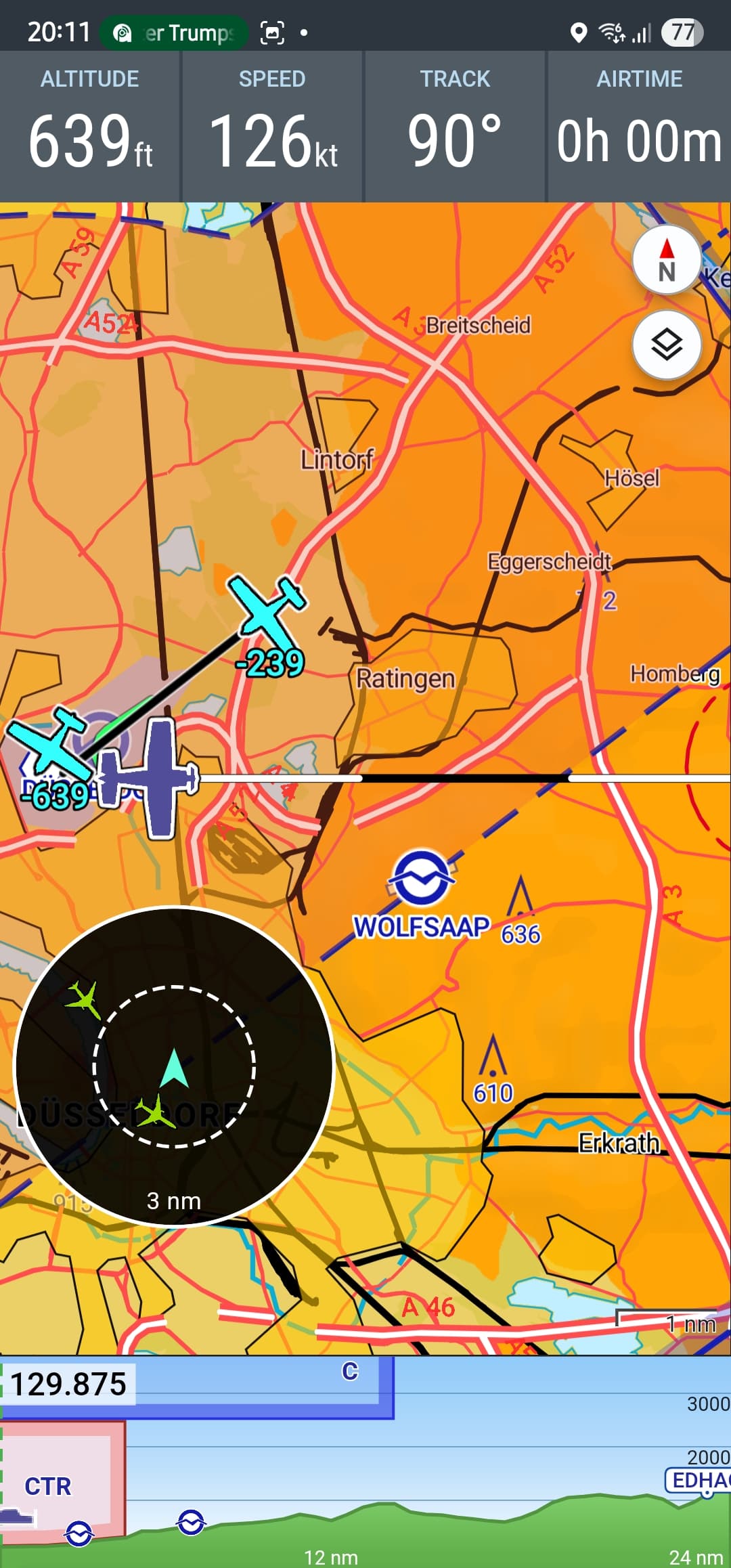

Windows Defender initially blocked the file: VirusTotal I suspect a false positive, but it’s a bit unfortunate.

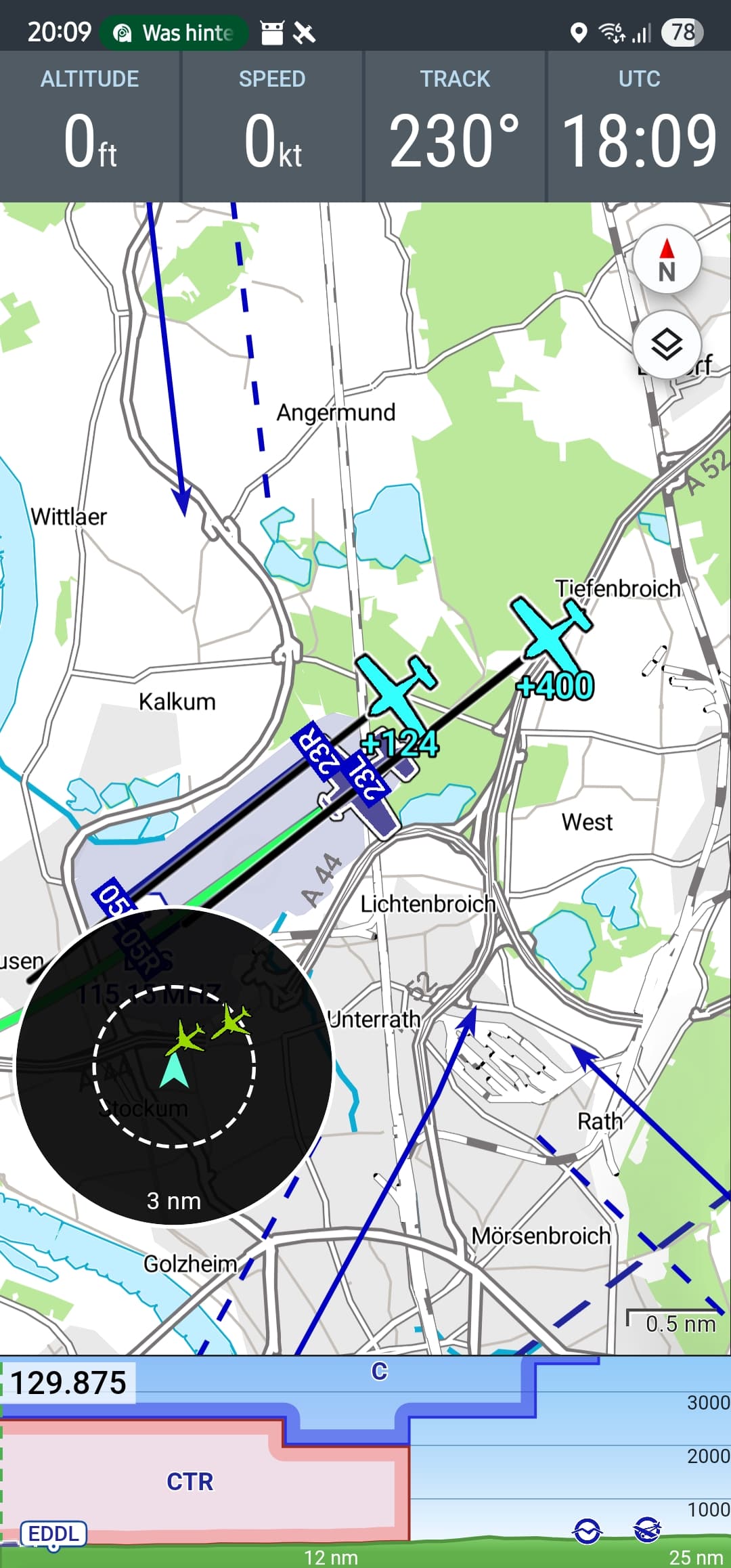

The traffic was displayed immediately:
This makes the most interesting features usable. Thanks for the quick update! I will definitely purchase the full version once the trial expires.

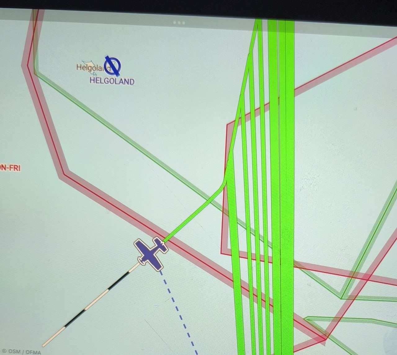

I’m using VFRNav (latest version) for real and simulated flying and I’m currently trying to transfer GPS data from MSFS2020 on my Windows 11 PC to my tablet (Android Doogee T20mini, alternatively also an iPad) using msfs2vfrnav.exe (latest version).
Unfortunately, the UDP connection regularly drops, even though the packets are being sent correctly from the PC.
As a result, the system keeps switching back and forth between the tablet’s GPS signal and the UDP data at short intervals (see image).
VFR_Nav_UDP
Details:
  • Packets from MSFS are currently sent as a broadcast to the subnet address .255.
  • Wireshark shows that the packets are correctly sent into the network once per second.
  • The tablets experience sporadic connection drops, especially on the Android device.
  • The iPad shows similar drops when using broadcast.
  • This can also be observed in VFRNav “External Data Source Status”
Note: I have already tried all the suggested measures on the tablets, e.g. disabled battery optimisation, allowed background activity, kept Wi-Fi on during standby, tweaked developer options, etc.
Unfortunately, I can’t optimise anything further in my home network.

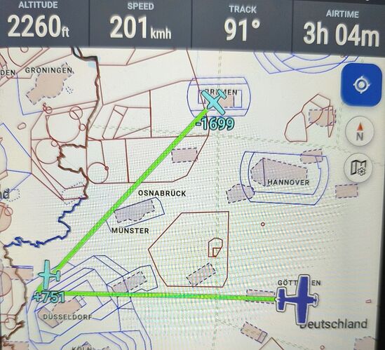

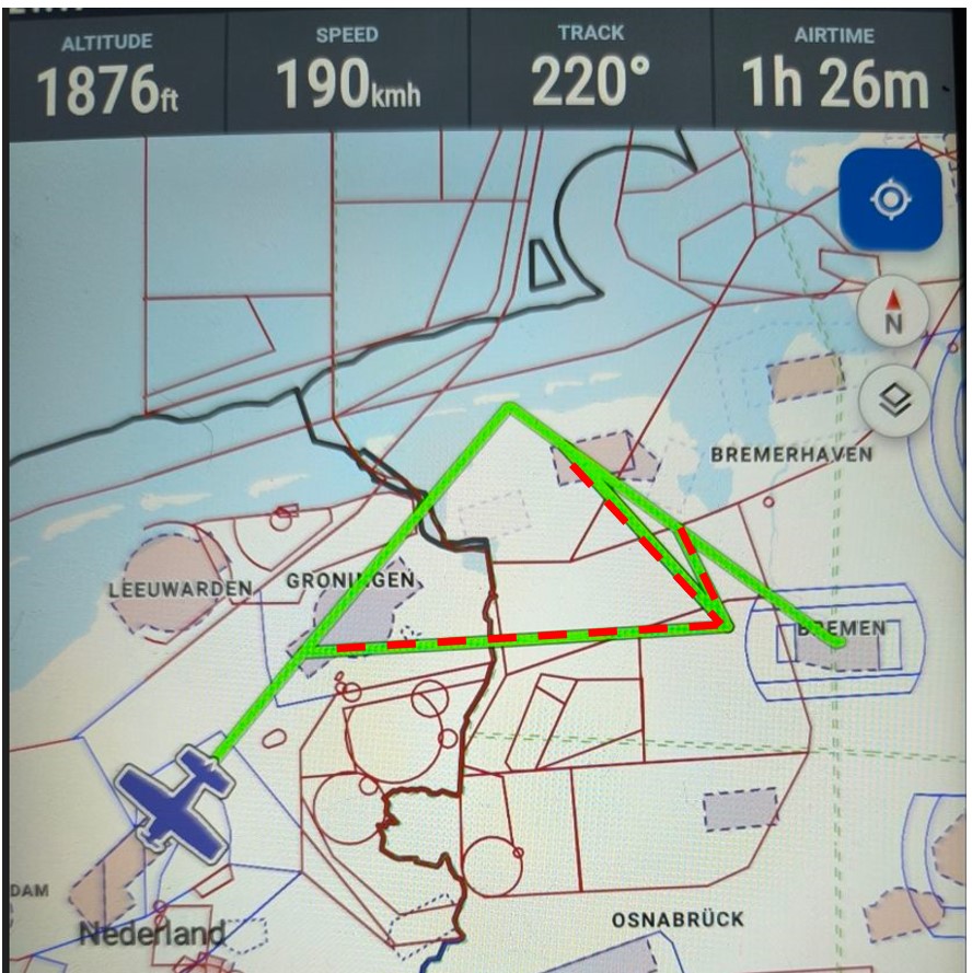

Hi Hermann,
There’s been a noticeable improvement after your change!
The airtime was almost 1h30 and there were only three dropouts.
SC_VFR_Nav
Many thanks for the great app and the speedy support!
Uwe

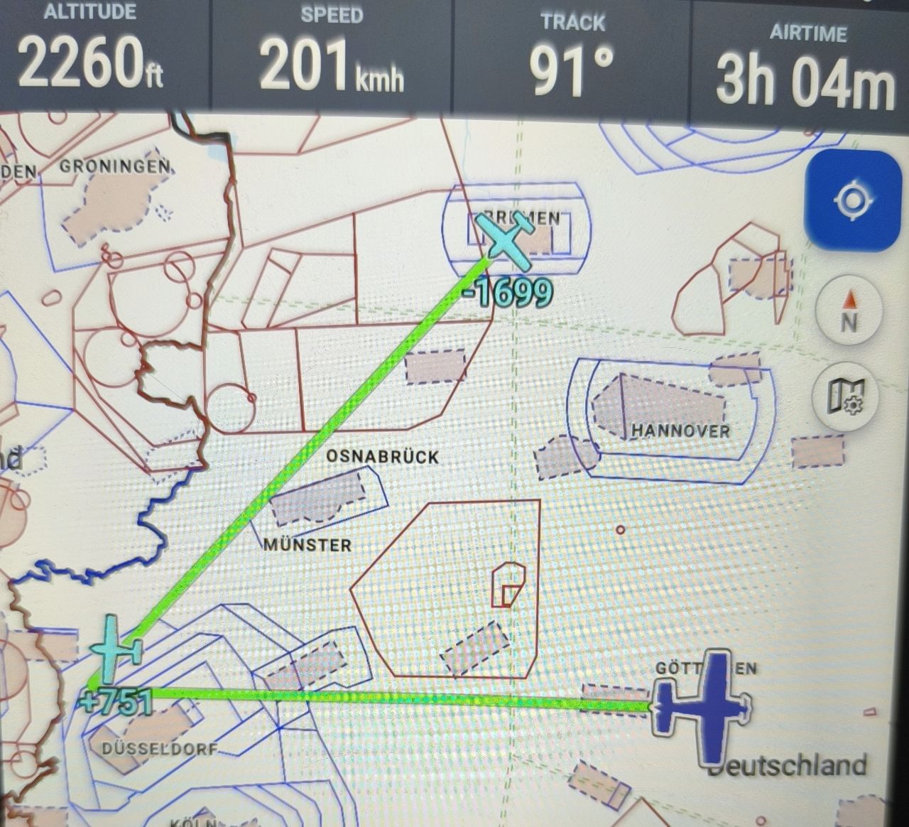

Hi Hermann,
Just a quick update: the second test run after the switch was much better.
VFR_Nav_UDP_unicast
Over 3 hours of airtime and not a single dropout. (Previously I had several within a minute.) Switching from broadcast to unicast was the solution!
Many thanks and best regards,
