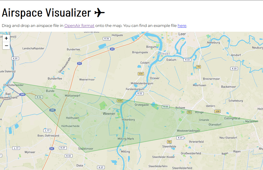

In the Airspace Visualizer the above polygon is also displayed.
grafik

In the Airspace Visualizer, the above file is displayed correctly.
