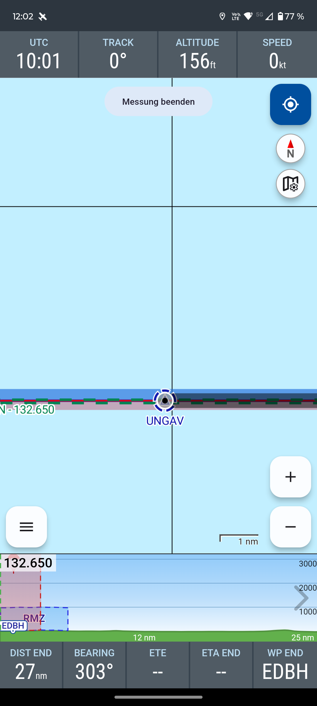

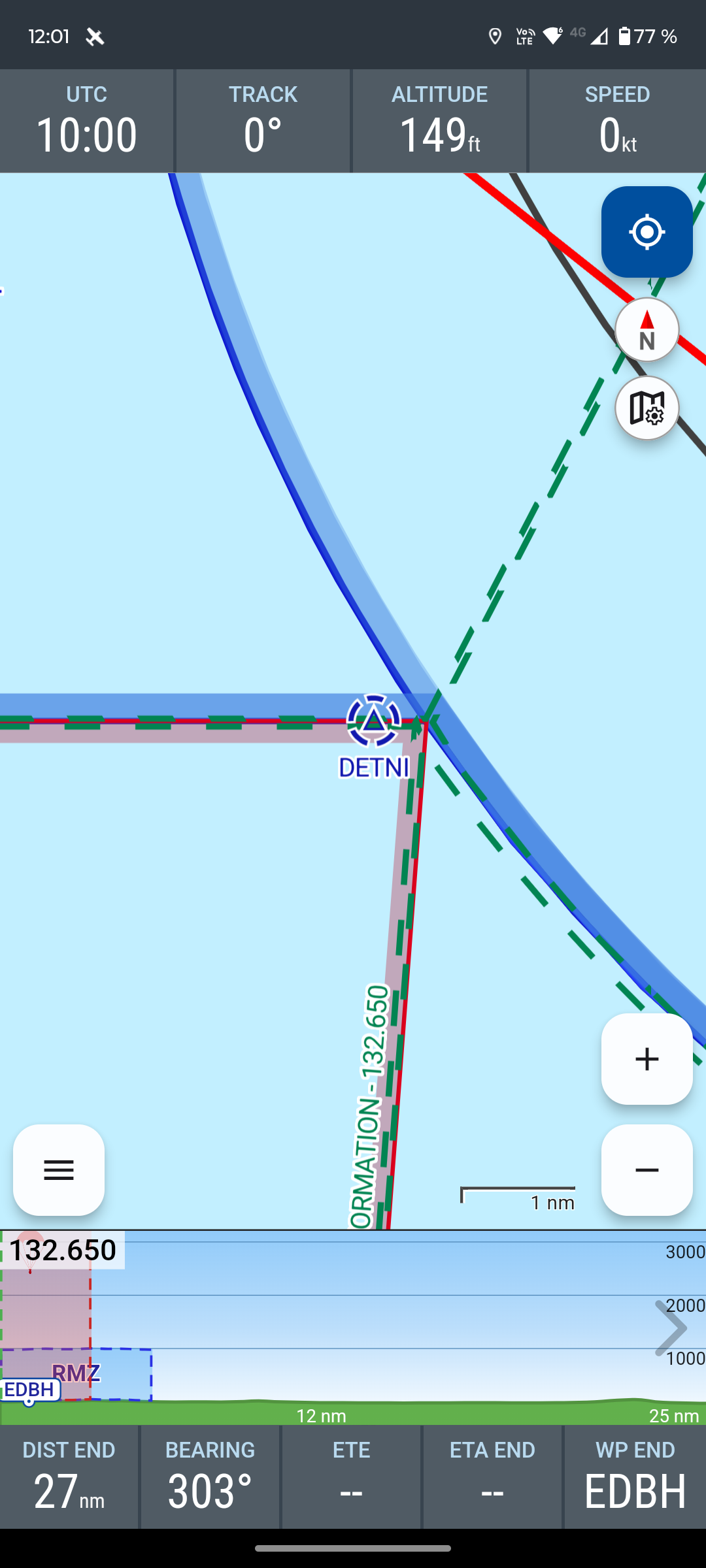

Hi Karsten,
the waypoints only appear at the 1 nm zoom level.
Which is pretty annoying for spontaneous changes or just in general.
Practical example:
We taxied out at EKRN with a flight plan, planning to depart via DETNI.
As we were rolling onto the runway we were suddenly given UNGAV instead of DETNI.
Finding the waypoint between radio calls, checklists and the takeoff roll wasn’t easy ![]()
Especially not for me, since it was my first time taking off from EKRN.
If you could see the waypoints at a different zoom level, you could quickly zoom out, adjust the route and zoom back in.
The same applies to VORs.
They would be easier to find and navigate to if they were visible at a more zoomed-out level, e.g. 10 nm.
Cheers, Daniel

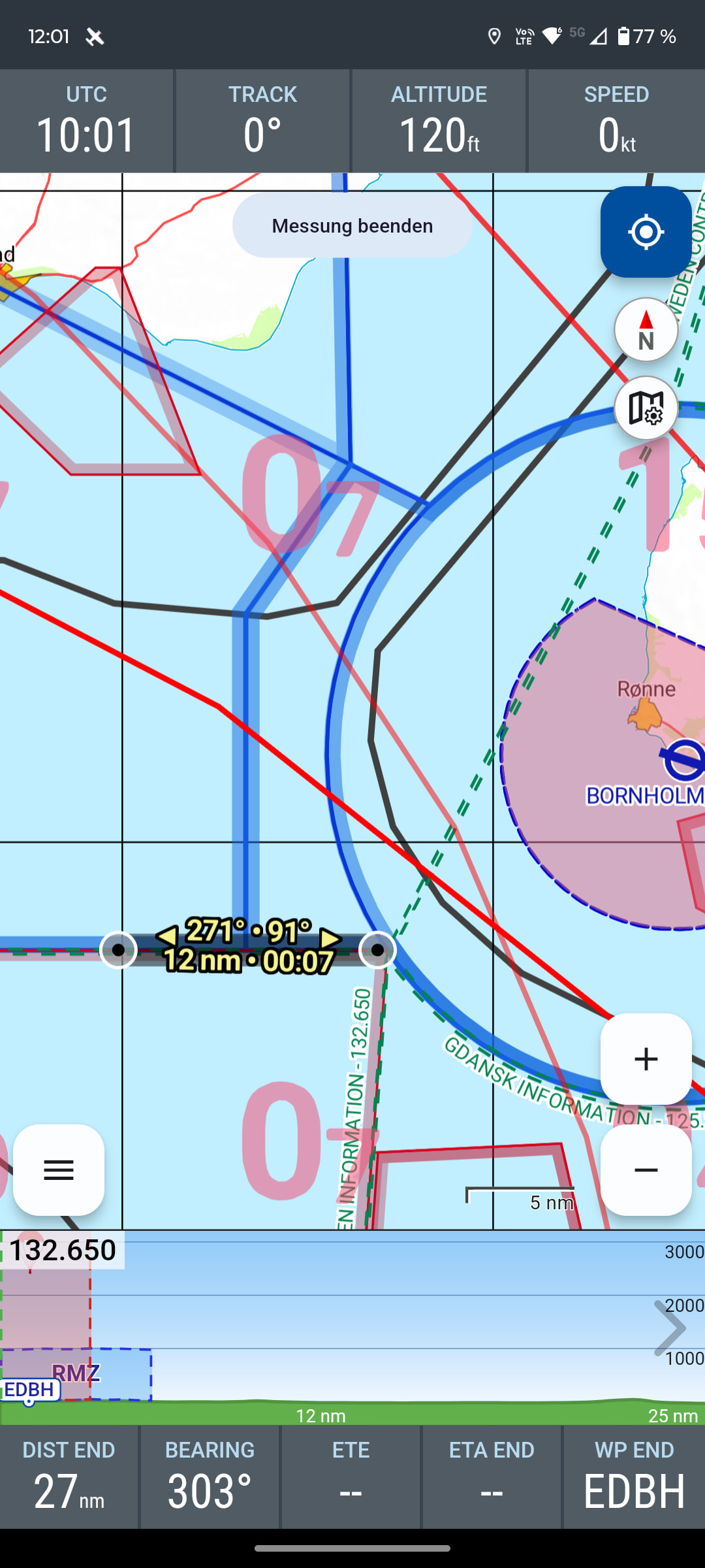

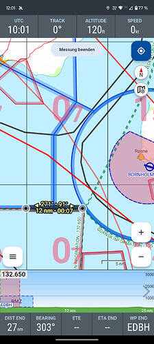

Thanks for the interesting contribution!
Rerouting itself works.
Either via the trash bin or in the route planner.
It would be easier if you could just drag the route.
However, the waypoints (WPs) are so far apart that you can’t do that. ![]()
That brings us back to the zoom issue.
Cheers, Daniel
