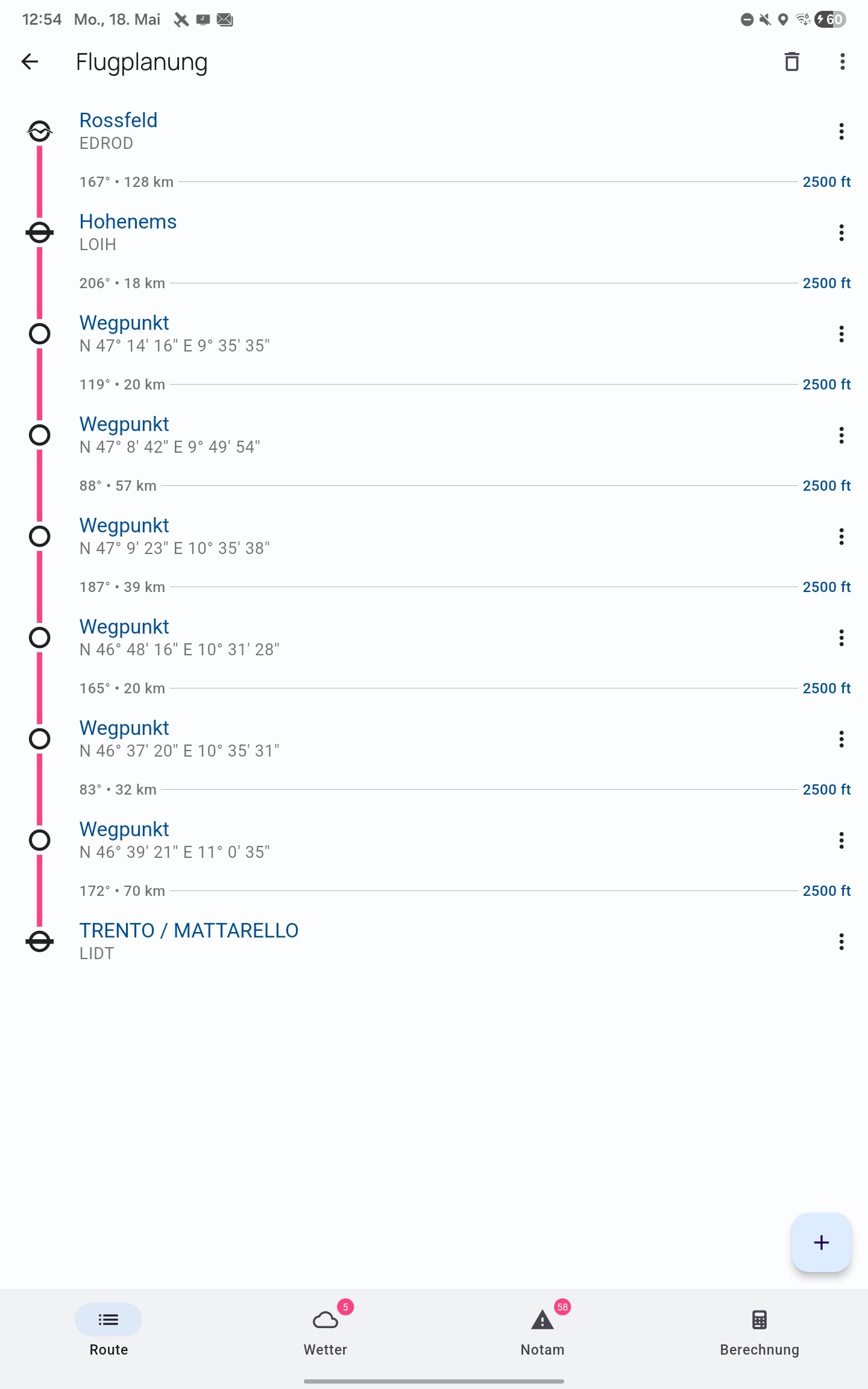

Ideally, submitting the flight plan directly from VFRNAV would be best, of course, but that would be a very extensive change.
What would already greatly simplify filing the flight plan, though, would be an “Export” of the flight-planning waypoints to the clipboard in the format expected by the flight plan.
From
it would then
LOIH DCT 4714N00936E DCT 4709N00950E DCT 4709N01036E DCT 4648N01031E DCT 4637N01035E DCT 4639N01101E
become. So only the ICAO code or the rounded coordinates ggmm[N|S]gggmm[E|W] separated by DCT.
Maybe as “copy to clipboard” in the three-dot menu.
Regards
Maik
