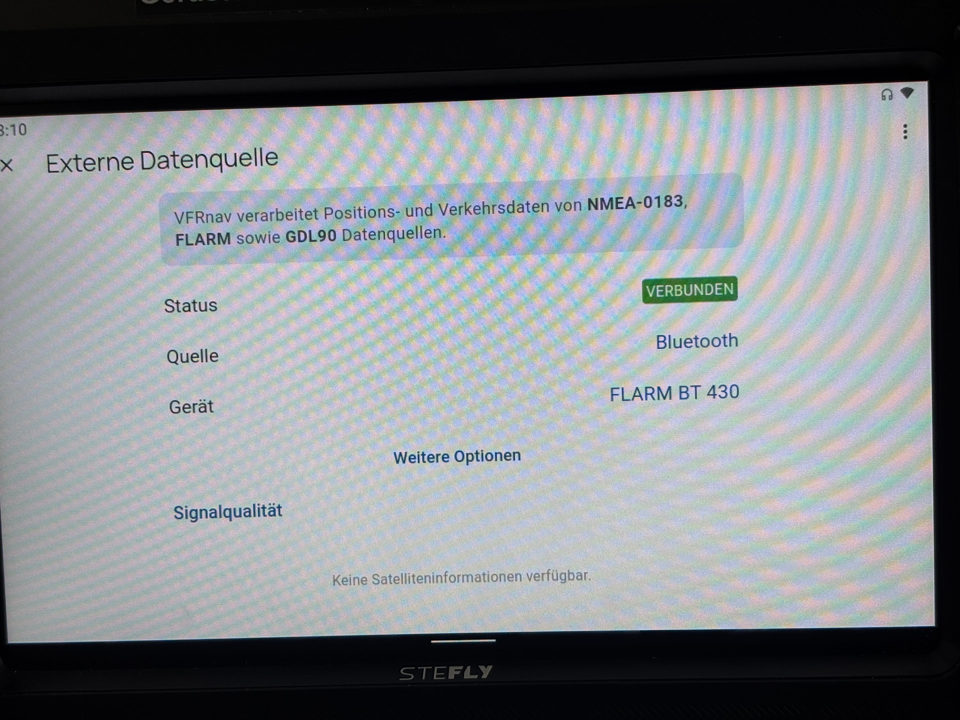

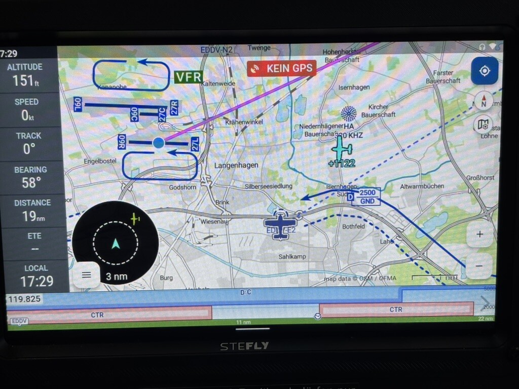

we have now installed a SteFly Nav 70 in our motor glider and would like to use VFRnav on it. The device has no built-in GPS. The location is provided together with the traffic data from the Flarm.
Both position and traffic are displayed reliably. Nevertheless the message “NO GPS” appears.

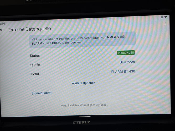

When Location + Location accuracy are enabled, the message mentioned above appears at startup.
Under Settings - Signal Quality it permanently says “Waiting for GPS”. I suspect the entire location logic in the program always refers to the internal GPS receiver.
If I completely revoke VFRnav’s permission for Location, the startup message no longer appears. In both cases it says “NO GPS” in red at the top, although the correct position from the Flarm is displayed correctly on the map.

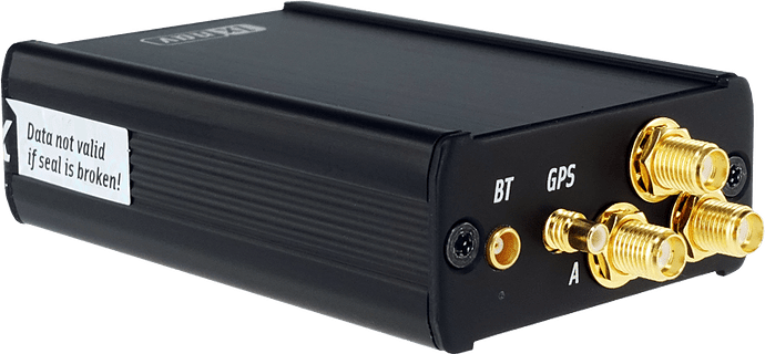

We have just installed a PowerMouse+. It is currently paired via BT (Bluetooth).

Ok, I think there’s a misunderstanding here. The PowerMouse+ is the Flarm.
