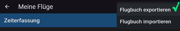

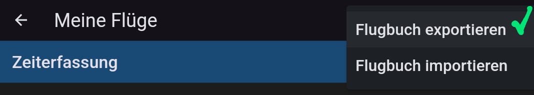

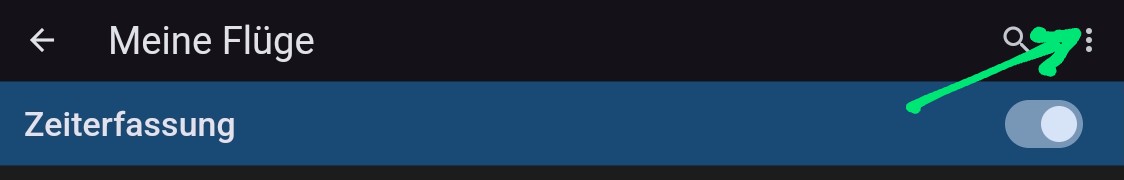

Start menu -> My Flights -> three dots
Screenshot_20250729_120521_VFRnav~2
Export logbook

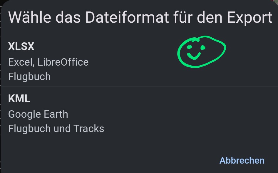

Choose the file format (I prefer Excel because of post-processing on PC)
Screenshot_20250729_120541_VFRnav~2
Important note: the association of the stored tracks is lost in the process!!!
This is a major disadvantage of this variant. If you don’t want that, choose the KML format.

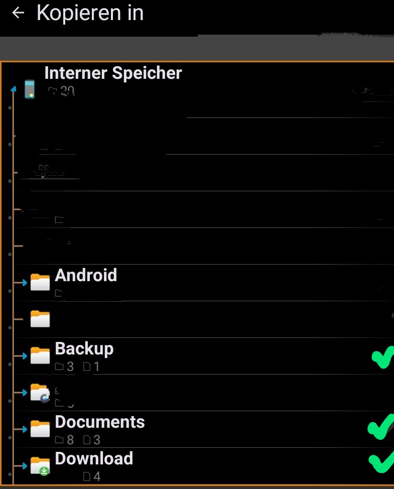

Select a storage location
– Attention! here choose a folder with personal rights, e.g. Documents
Screenshot_20250729_120657_X-plore~3
Now the logbook is saved in the above folder. Great, you have a local backup right away.

we download the file from the email onto our phone. Typically the file then resides in the Download folder. I recommend copying it immediately into the personal folder to avoid access-right issues later. The copying is easiest with a file or directory explorer of your choice, or the preinstalled tool. (I use X-plore full version by Michal Bacik, for example.)

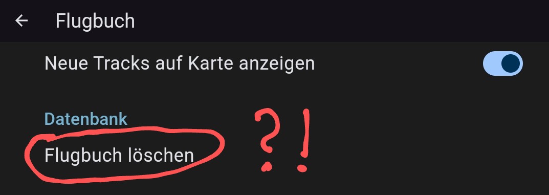

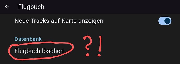

Now we delete the existing logbook on the phone:
Settings → Logbook → Delete logbook

The same procedure applies as for the export described above, only we choose Import instead of Export!
